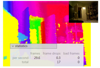

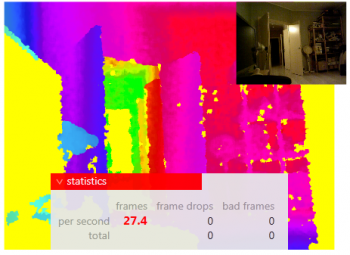

Camera statistics
At the bottom of each camera screen on Recorder tab there is an expander called statistics. It contains several values indicating video capture performance from that camera. You can see the number of (good) frames, frame drops, and bad frames per second. You can also see total number of frame drops and bad frames since the last initialization of a camera.
A frame drop is detected when camera does not report the next frame at all. A bad frame is detected when camera reports the next frame, but does not supply complete data for it. High values of any of these numbers usually means some USB issue. You can try to resolve this by replugging a camera to a different USB port, or getting an additional USB controller. The value of frames per second is influenced by other numbers, but also may be lower than selected mode's frame rate due to instable frame rate of the camera itself (this is common case with conventional web cams).
Any "bad" values in statistics are indicated by red color, and statistics are expanded automatically when such values are encountered.
Tip. It is normal to have bad statistics for a few seconds after just switching to Recorder tab, because cameras are reinitialized.
Good camera statistics
Bad camera statistics

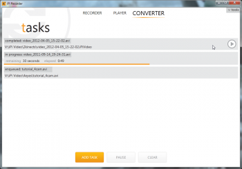

Converter
Converter tab allows you to convert AVI videos recorded with the previous versions of iPi Recorder (1.x) to use with the current version of iPi Mocap Studio.
To start conversion, press ADD TASK button. You will be presented with a file selection dialog. After selecting a file, you get to the input parameters page. The layout of selected AVI file (kind and number of cameras, video mode) in most cases is determined automatically. In case of any inaccuracies, you can make manual adjustments. Layout parameters are the same that were used when opening AVI file in iPi Studio 1.x. Then press NEXT button to go to the output parameters page. Here you specify start and length of the background portion of the video. When dragging these sliders, a thumbnail for corresponding video frame is displayed to help you figure out proper values. Also you set compression options, which are essentially the same as in recording, but in conversion you should not bother about CPU load, because it does not require realtime performance. When all parameters are set, just press ADD button, and conversion begins (or is scheduled).
Tip. To save your time, you can select multiple files at once when adding conversion task. In this case they should all have the same layout (number of cameras and video mode), and also similar time boundaries for the background portion. Because input and background parameters will be the same for all files. When specifying output file name you can use some placeholders for parts of input file name to make output file names differ from each other. For details, see tooltip for the output files pattern field. All output files are placed in the same folder. After pressing ADD button, multiple tasks will be added to the task list, one for each input file.
Conversion of each individual video file is represented as an item in the task list. This list contains all conversions that are completed or scheduled during current launch of iPi Recorder. At top there are completed tasks, you can open converted videos in player. Next is currently processing conversion, you can see its progress and cancel it. At the bottom of the list there are scheduled tasks, which also can be cancelled. When currently executing conversion is complete, the next scheduled task starts automatically. You can cancel all tasks at once by pressing CLEAR button.
If you need CPU resources consumed by current conversion for other activities (for example, for recording), you can pause it with the corresponding button. Later you can continue conversion with RESUME button, just do not close iPi Recorder, or you'll lose your progress.
Converter input
Converter output
Converter task list
