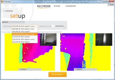

- Run iPi Recorder.
- Color stream should be recorded along with depth data. That's why only modes "(depth+color)" can be used.
- Avoid bright lightening and white objects on background during recording of calibration video.
