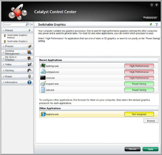

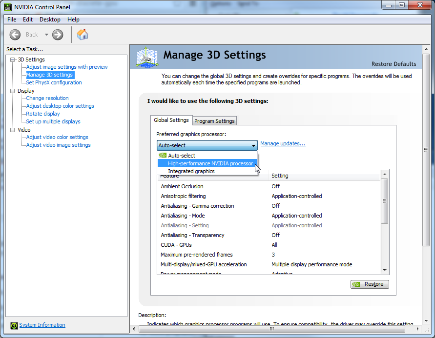

Some laptop models have physical button to switch between GPUs. But on most models, this is configured in the graphics control panel. For NVIDIA-based laptops it's '''NVIDIA Control Panel''', for AMD-based it's '''Catalyst Control Center'''. There you can usually set either global usage of high-performance GPU for all programs, or specify a GPU to be used on per-program basis.
[[Image:NVIDIA-control-panel.png|frame|center|300px|NVIDIA Control Panel]]
[[Image:Catalyst-control-center.png|frame|center|300px|Catalyst Control Center]]
A control panel may allow you to choose the program to configure from a list of installed programs, or from a list of running programs. If none of these options is available, then you'll need to get the full path to executable file of '''iPi Mocap Studio'''. A simple way to find it out is to:
A control panel may allow you to choose the program to configure from a list of installed programs, or from a list of running programs. If none of these options is available, then you'll need to get the full path to executable file of iPi Mocap Studio. A simple way to find it out is to:
