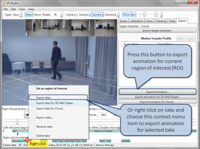

Use “File->Export Animation” menu item to export all animation frames from within Region of Interest.
To export animation for specific take, right-click on take and select “Export Animation” item from pop-up menu.

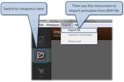

Animeeple

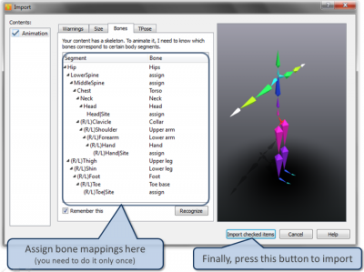

When importing motions into Animeeple, you may need to do the following adjustments:
  • Click “Set first frame” on the “TPose” tab in import dialog.
  • Assign bone mappings on the “Bones” tab:
SegmentBone
HipHips
 LowerSpine---
  MiddleSpine---
   ChestTorso
    NeckNeck
     HeadHead
      Head|Site---
    (R/L)ClavicleCollar
     (R/L)ShoulderUpper arm
      (R/L)ForearmLower arm
       (R/L)HandHand
        (R/L)Hand|Site---
 (R/L)ThighUpper leg
  (R/L)ShinLower leg
   (R/L)FootFoot
    (R/L)ToeToe base
     (R/L)Toe|Site---

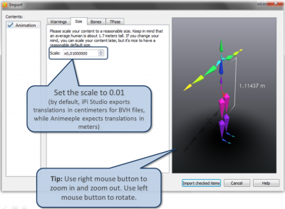

  • Set the scale to 0.01 on the “Size” tab (by default, iPi Studio exports translations in centimeters for BVH files, while Animeeple expects translations in meters).

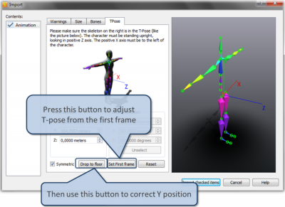

  • Set “Root position: Y:” to a correct value on the “TPose” tab, or click “Drop to floor”.
