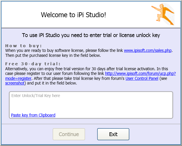

iPi Studio is a core software of iPi Desktop Motion Capture (iPi DMC) solution. It’s used to process pre-recorded video and export resulted animation into most popular formats. You can use 30 days free trial. To install iPi Studio please download and run setup program: http://ipisoft.com/downloads/iPiStudioSetup.exe. Then, follow instructions of the installation wizard.

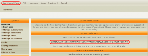

As a result of installation, iPi Studio will be executed. You will be prompted to enter unlock/trial key:
To obtain trial key please register to our user community forum: http://ipisoft.com/forum/ucp.php?mode=register. After registration please login to forum and take trial license key from forum’s “User Control Panel”:
Click to enlarge
Note that if you don’t receive activation e-mail after registration then:
  1. Make sure that this e-mail is not in “Spam” folder of your mail client.
  2. Check that you have entered correct e-mail address.
  3. Try to resend activation email. To do it, go to login page and click “Resend activation e-mail” link.
